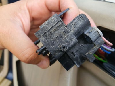

Here are some pics and part numbers:
I'm not quite sure what the part number for this switch is supposed to be though...any ideas? looks like a bunch of connector plug part numbers. Either that or I need to get the whole black block thing, part number 124 821 28 51?
You would have to get the main switch block unit but that motor sounds less than 100%, might need a bit of lube! If you aren't getting 12v out of the violet and blue when operated then it is the switch unit.
