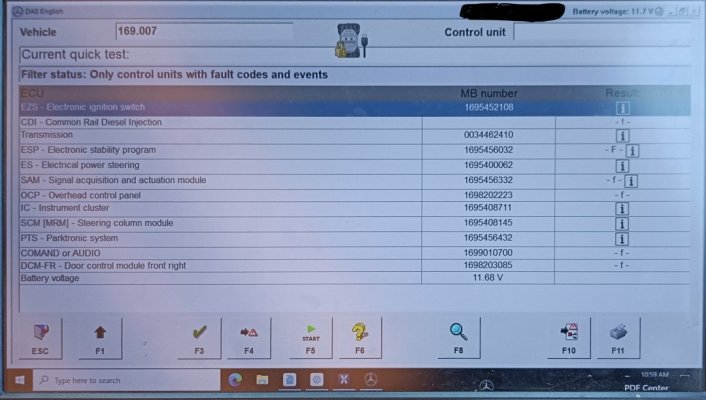

I have an issue with my car and it is not starting
Car details
Issue background
Tests
As the OBD2 is not able to connect, iam thinking this could be due to engine ECU and I might need the new kit
As there is not crank and car was actually cut-off , i'm thinking it could be Crankshift sensor as well [ im unable to locate this to check physically]
As there are no codes to look at.. I'm completely blocked.
Any help is much appriciated
Car details
- Mercedes A-class 2008
- Model - A180 CDI Diesel
- Engine - W169
Issue background
- Day1 - While driving at around 50mph , "ESP inoperative" message appeated for 2 secs. This followed by "Display inoperative" message for a second and car came to a stop. I had to remove the Key and wait a minute and then car started normally and drove good for the day.
- Day-2 - the same sequence of messages and I had to wait for 15mins for car to start and all good for that day.
- Day-3 - same sequence of messages when i was close to home and this time it is not starting at all. When put the key in position-2, it shows "Oil level cannot me measured" message. No crank but i can hear the starter
Tests
- Battery is good and showing 12.4v
- All the electricals are working [lights, locking, windows, horn, wipers, socket etc..]
- I have tried disconnecting the batttery negetive for 60mins and tried starting the car, no luck
- I've checked all the wiring under the bonnet and everything seems to be connected
- I've tried connecting an OBD2 scanner and it didnt power up.
