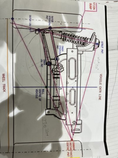

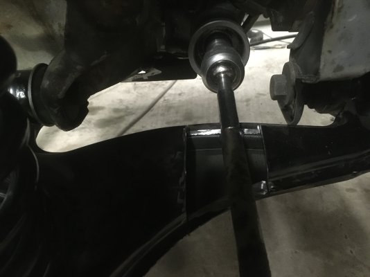

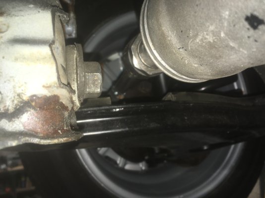

The below sketch is what I have got and the other is something I’ve been working from. Can anyone shed any light if this should work because I’ve got about 1-2 mm of toe for every inch of suspension travel and at full droop which is about 6 inches!! It goes very bad. I’m not sure how good it actually has to be because I’ve not driven it to see how it feels, I don’t want to drive it because it’s very much mocked up on the tie rods at the moment. I’m going to have to make new tie rod to front hub brackets and I don’t want to do that twice.
I can’t place the rack anywhere else because there is no room for it to go anywhere else and to be honest to me it seems like a pretty good location anyway. I’ve had to notch and strengthen the lower arms as it is ….
