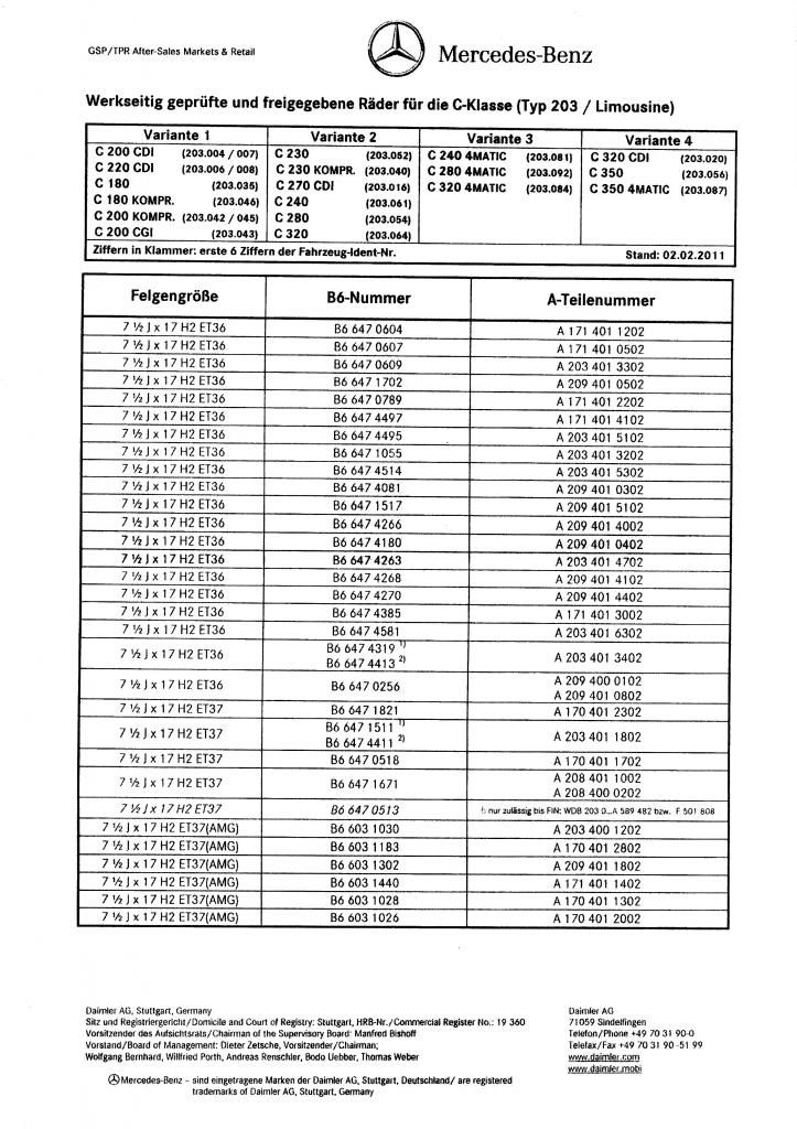

Will 16 inch wheels clear your brake calipers / discs? Check your handbook, the list of approved wheel and tyre sizes should be there.

My 2005 W203 has Adharaz wheels and the Sport Pack. The calipers are too big for 16" wheels so you will need to go 7.5J 225/45 17s all round which is what I do with my winter tyres and wheels. This is what the manufacturer recommends so should not be a problem with insurance.
