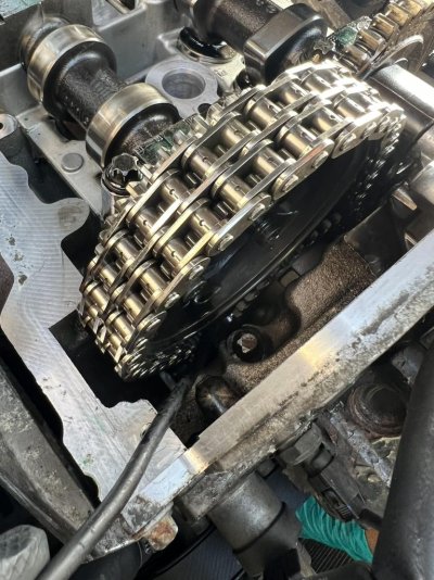

Well done Cristispot. Nice to here its back on the road. Got an update on my old girl too. So, with endoscope purchased and pushed down the side of the cam chain I found the little bleeder! Sat on top of the lower cam chain gears. There was no way that was coming out out. So managed to flick it into the sump. Replacement cam cover, new injectors fitted and oil changed she runs like a dream. Could have gone completely the other way if I hadnt have found the piece for sure.
Glad you got yours fixed too mate. Enjoy it as much as you can because it is a really good reliable motor.
That is exactly where mine was stuck too :D so i have no idea how Olly got it out.
