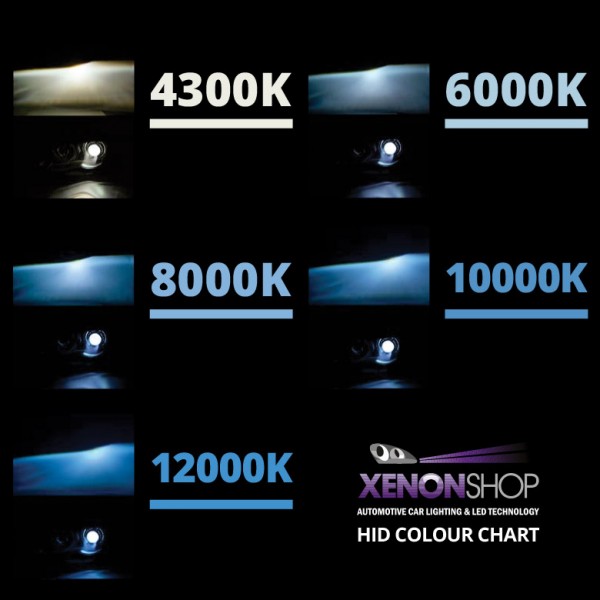

4300k is the oem bulb temp
I went for 6000k, in my opinion, brighter and more white, just what I wanted...

Did you find a big difference with the 6000k bulb compared to the oem bulb ?

I went for OEM Philips 4300K on mine. Nice bright, white light. 4300K is the OEM colour temperature.
I must confess that currently, I don't drive much at night(!), but just automatically go for 6000k bulbs as I've used them in my other car for about 10 years! (a Celica GT4). I mainly like the colour purely for aesthetic reasons. I just think the OEM colour looks old fashioned, but there's nothing intrinsically wrong with them...
