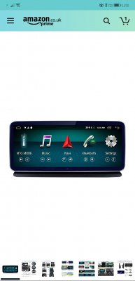

This is the type of android I have been looking at. Easy enough to install yourself but can you still you the dial in the centre console to control it?
Is there much messing around with the wiring I wonder, I wouldn't be great the the electrics šŸ¤¦ā€ā™‚ļø

I went for the original look and feel and had my Audio 20 replaced by COMAND NTG4.7.
The work was carried-out by www.comandonline.co.uk who did a first class job - I can't recommend them enough.
That said, I can see why some will be reluctant to go down that route. Firstly, the original MB equipment (be it COMAND, the rear-view camera, etc) is high-quality kit and and MB-branded, so obviously not cheap. Then, automotive systems tend to go through a lengthy internal testing and approval process, using tried-and-tested technologies, compared to high-tech companies who rush to market with half-baked products in order to be able to offer cutting-edge technology at the expense of reliability. Which means that by the time a car manufacturer releases a new infotainment system, it is likely to be based on technology that in the electric equipment shops is already considered obsolete. Let alone when considering an older model... NTG4.7 is the third generation of the NTG4.5, which was first seen in late 2010 (on MY 2011 cars), so would have been in development since around roughly early 2008. Just to give an idea of time line, there were no smartphones then... the first smartphone (iPhone 3) was released later in the same year.
Personally, as a Merc enthusiast, I wouldn't fit a non-original infotainment system, but I can see why some would. No doubt the extra functionality and flexibility offered by a an Android unit will sway many owners to move away from COMAND.
I also believe that in future car manufacturers will give-up on developing propriety infotainment systems, which broadly duplicate your smartphone functionality. I think that eventually cars will simply have a touchscreen unit with Apple CarPlay / Android Auto / MirroLink functionality (in addition to the car management system controlling various features such as the suspension settings etc etc).
