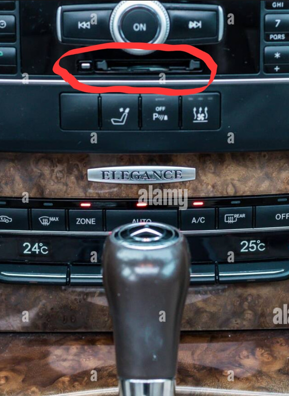

The W212 had NTG4.5 until late 2015, when it got the NTG5*1. What year is the car? 2016 was the last year of the W212.
So it's the pre-facelift model, and will have either Audio20 or COMAND NTG4.
If it's COMAND, then the unit will have a large PCMCIA bay, that's how you recognise it:
I can confirm you that mine is equipped with COMAND, so NTG4. So ? Thanks for your answers !
