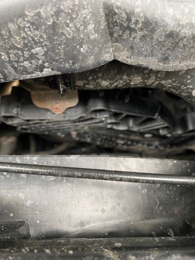

So planning some work in up and coming week`s , so was looking at changing drive belt and pully`s so this ,
So question what`s is it and what`s its purpose ??? ( and Yes under bonnet needs a booming good clean weather doesnt help lol )
It’s called a resonator box, it quietens the air from the turbo to the intercooler. It’s literally just a hollow plastic box designed to reduce noise.
thank you, you are a star :thumb:
I don't know anybody that's removed it - you'd have to fashion some kind of pipe to go from the metal pipe coming off the turbo to the silicone S-shaped pipe that goes into the intercooler. Probably best to just leave it alone...
thank you I will :thumb:
