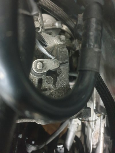

So my switch over valve has a snapped plastic arm therefore it doesnt work..no symptoms but easy to replace.best to get it fixed as it makes everything work as it should. Picture attached
