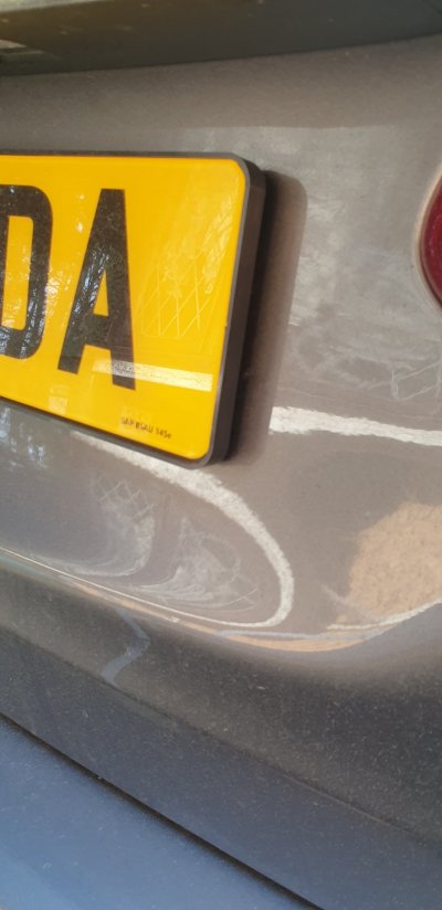

Sounds like my issue is the same, Estate version of W213 and I cannot see how to get the plate out of the frame. I dont have to unscrew it from the inside of the tailgate do I ? How do I remove the plate without snapping it ?20240117_140259.jpg
Sounds like my issue is the same, Estate version of W213 and I cannot see how to get the plate out of the frame. I dont have to unscrew it from the inside of the tailgate do I ? How do I remove the plate without snapping it ?View attachment 152049
The yellow plate is held to the black frame using sticky pads.
Fine screwdriver between the yellow plate and black frame, at one end. Lever it up carefully, pushing the screwdriver in further as the gap opens up. Lever it up further to break the hold of the sticky pads.
It’s unlikely to snake the plate unless they’ve use lots of No More Nails. Take care of the paintwork, to ensure the screwdriver doesn’t mark it.
