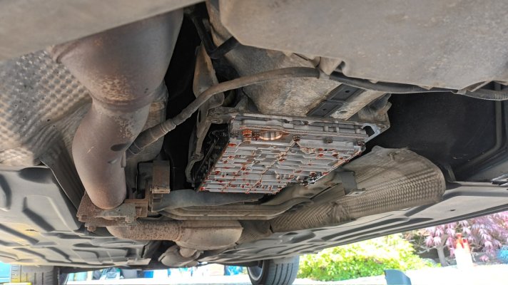

Just spent a couple of hours sweating in the heat under the car . Front wheels on wheel ramps (drive is sloped so it sort of makes the gearbox level ) .
I had bought a Febi filter and sump gasket kit for £10 ish recently , I was going to save it for a while but there wasn’t much wind today so I thought better in the car than in the garage . I have 8L of Fuchs 236.14 on the shelf as well .
Last ATF and filter change was @79k and 3 years ago ….now on 97k . I actually change the sump ATF yearly with a Pela pump anyway so this wasn’t too excessive for me . I did change the gearbox electrical connection last year so actually missed my normal ATF change anyway .
Much easier than the 7g to change and I’d done it a couple or so times before ,so no stress involved .
The sump tray is with magnets removed and before cleaning , no metal horrors were spotted .
I will check the level in a couple of days , I just replaced the 3L of atf I drained out

Just done a 20 minute drive , level checked and 0.5L added . That’s it for another year .
