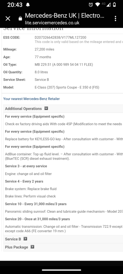

Wonder what code a66 is ? But this is the ess for my e350.

I can see the error now on that Ess . It's listing my e350 as 722.9 which was the 7g transmission. Goes to show you can't trust 100% what's listed on these websites. The 9g is 725
E207 is the last gen E Class Coupe (current model is A238) and the 207 is fitted with a 7G gearbox (722.9) and not 9G (725).....
Mine was a facelift c207 very late 2016 , registered in march 2017. It had 9g on the facelift versions. 👍
