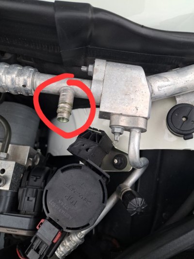

Got some sad news. I removed the cap on the low pressure side, assuming that's the larger pipe? Unfortunately its empty, no gas behind the schrader, so there is definitely a leak somewhere?

You have dye on board already to assist your search. I can see it in the valve ;)

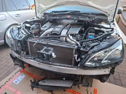

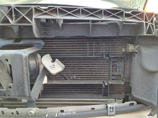

Just an update, had a bit of free time today so took the bumper out for inspection.

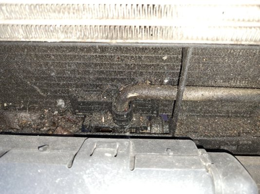

Jobsworth was correct, the condenser panel looks like it's seen better days. The panel is very wet and oily at the lowest exposed section. I couldn't make out where it had been punctured but it definitely needs to be replaced. Must have been a stone or something that went through the air vents and knocked a hole on the panel.
Next step is to place an order for a brand new condenser panel. I have no idea how it's assembled together in the pack? I reckon the slam panel will need to be removed.
I wonder if I could get away from removing the radiator. Ideally would be nice not to empty the coolant, that's extra work.
