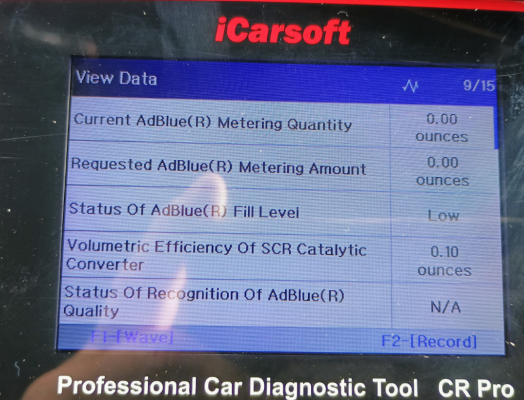

I have an icars V2, anything I can use on that to check? Is this car in trouble?

Put the icarsoft on my glc today . So what do I believe? The car or these inept icarsoft scanners . 🤔🤔🤔. Range has dropped from 8100 miles on two top up occasions in 2 years.
