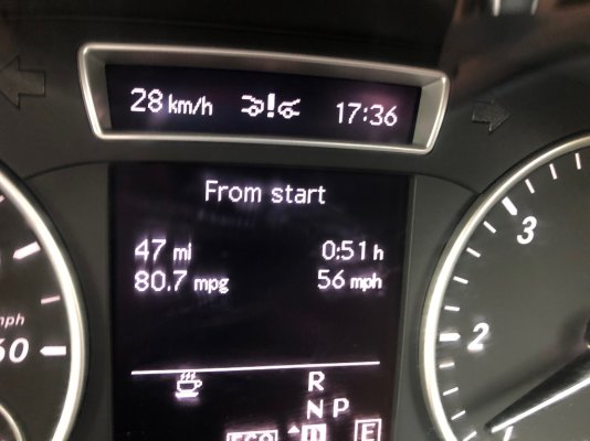

Coming back home from the Lake District I got 70 mpg, and a recent trip to Lincoln got me 80 mpg.
