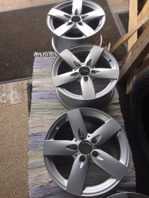

What a mess! My wheels seem to be corroding from the inside out. Surface feels smooth to the touch. All four are like this. I'm guessing they are beyond repair.
The wheels can be refurbished.
But if the car is still under warranty and the wheels are original, it's worth checking with your dealer first to see if MB will repair/replace the wheels under warranty (some MB wheels are prone to corrosion for no obvious reason).
Though they might say that the damage was caused through the use of acidic wheel cleaner (which, to be honest, looking at the photos, does seem likely), or that the hub was damaged by a tyre filter using a screwdriver to prise-off the cap (sadly they do that) and which allowed moisture to creep-in under the paint.
But failing that, have the wheels returned, and be careful with the wheels cleaner and the tyre fitters going forward.

Seems unusal, normally they can cut more than once. There are some high-sheen finishes available which don’t require cutting, so worth asking what alternative options are available. Whereabouts are you?
Cheltenham
If you can get to Birmingham there are quite a few refurb outfits - some same day turnaround - who might give you some different options. Worth a Google and enquiry.
Even if they can't be diamond cut again they could be painted/coated - which would look better than they are now.
