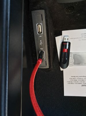

I bought a May 2015 facelift S212 a few weeks ago and wanted to enable CarPlay & Android Auto.
I discovered as long as I had the right headunit, in my case an NTG 5.1, it was possible with the right firmware installed. Luckily these started to be installed in the W212 / S212 in March 2015 for the MY2016 vehicles with SA531 on the datacard which I had.
Unfortunately I'm at the other end of the country to COMAND Online so I went down the route of sorting it myself (in hindsight I should have driven to them and saved myself from a world of pain).
I took the car to a local specialist in Skipton who said they could do it, left the car with them for a few hours and got back to find out they couldn't do it as their diags were too old (you need DoIP for the update). They still charged me and after paying revealed they'd tried to do it for another customer and just assumed it was a one off issue but after seeing this they were going to get their diags updated. Shame they couldn't have warned me off first. Sh1t happens.
I then went down the route of doing it myself with a Vxdiag C6 I bought but that was another palava. I was sent a BMW licensed version and it took a week to sort out adding a Mercedes license to it instead so I could use it with Xentry. So I sorted that out and now have a fully working system with online coding seeming to work well on the CAN side of things.
It turned out after buying an SCN login and getting the 3 Telematics disks it needed that it had issues with DoIP with the new Xentry build. Initially it passed the DoIP tests but an update killed it and they're sending me another disk over from China with the right configs so the jury is out on that one.
Anyway, I then found out that the Live Traffic service I was paying for via Mercedes Me wasn't working either, so using a mixture of that and various other issues I'd been having I booked it into Mercedes who got it all updated for me today to the latest COMAND Online, DAB & Sound System software versions. This has tweaked some of the look and feel of the original 2015 software and will hopefully cure my Bluetooth issues (sometimes the other end was getting pure silence).
I don't know if it was pure luck or a coincidence but literally as the dealer finished the updates, the ticket I'd logged with Mercedes Me got looked at and they disabled the service and reactivated from their location in Germany and confirmed it was now working - I'm guessing the newer software probably helped matters.

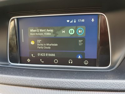

So in all good news today - my COMAND Online, DAB & Sound System got the latest update, the car flew through it's health check and the Eastern European eBay CarPlay / Android Auto activation tool worked fine with my facelift S212.
I didn't realise TomTom Go doesn't work with Android Auto yet so I'll probably flick between using the phone for that and trying Android Auto.
Software wise I had High_CY15_5 installed from 2015 and the latest version I've had installed today was High_CY15_9 18/24 which works with CarPlay and Android Auto (just adding that info in case anyone else tries).
This was the activator I used - some of the cheaper ones I read don't work with the latest software version but whether that's true I don't know.
The eBay ad says it's quick but in my car today it took over 8 minutes from plugging it in to it succeeding in everything it needed to do.
https://www.ebay.co.uk/itm/MERCEDES-COMAND-Audio20-CarPlay-Android-Auto-OBD-unlock-activator-2016-2019-cars/262451909947
So it is possible to do all this yourself, but it can be a right ballache. There's always the risk with these units that a future COMAND Online update could disable the features as they're not on my datacard but at least I now have Vediamo (I just need to learn how it works and my first trick will be working out video in motion) :)
Time wise I'm probably better off although with all the faffing I've done it's debatable.
Good result!
Just wondering, why do you also need TomTom Go on Android Auto, if you have COMAND with the TomTom Live Traffic subscription?
Purely habit as I've been using it for years now - it's cheaper but have to admit I haven't found a good place to put my phone yet so if the built in works as well then I'll just try moving over. I keep meaning to add the speed cameras so that's next on my to-do list.
I did see iPhone got a new TomTom update to work with Carplay so hopefully Android won't be far behind.
It doesn't seem like you have any control over the equalizer or Logic 7 etc when in Android Auto, it's all new to me but I do like the fact it lets you play all the music services - I think the W213 has this anyway.

It is listed as a requirement but works via Port 2 on the ones I have installed in my S212. The new ones also have the icon to make it more obvious.
I've not had a USB charger doctor on there yet to see how many volts / what ampage the phone is pulling but guessing it may be related to a better quality charging path for devices that try to pull more ampage. Although saying that I did 200 miles yesterday and didn't see any sign of the phone draining while Android Auto was in use.
