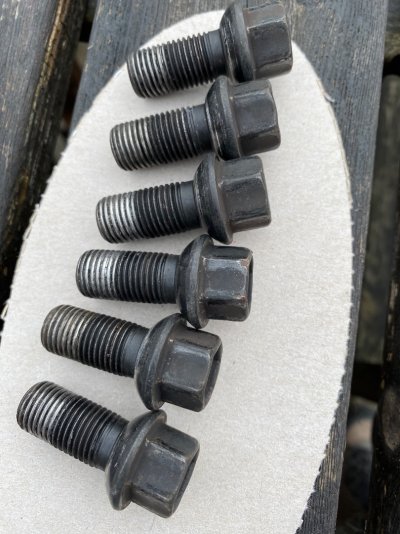

I usually have tyres delivered to my local garage for fitting, but couldn’t get the Asymmetric 6’s for the SL delivered for anywhere near the ATS fitted price. Really wish I had followed my gut instinct and paid the extra. ATS managed to strip 6 of the wheel bolts claiming previous damage!
The last time the wheels were off was at the service at my indie back in August. Reckon I’d have lost the wheels by then.
Gingerly drove it to my indie and they were able to retap the threads and supply new wheel bolts.
A complaint to ATS got the standard denial so I submitted a section 75 claim with my credit card, and this morning had confirmation that my claim was successful.

Classic poor practice at the tyre bay. What usually causes it is fitment of bolt into socket of wheel gun, then gun applied to wheel and car without manually starting the thread. I really don’t know what goes through their heads…

My thoughts exactly and the opinion of my indie who’s report helped swing the section 75 refund

Never had an issue myself.... the tyre places I use for the work vehicles remove them with the gun ( as I do if I'm working on the car at home)...start them with a very slow gun to make sure they are not cross threaded and spin them in on the gun with a light torque setting....and then torque then correctly with a wrench.
I'd be pretty concerned about the threads your indie retapped. The hubs are usually cast iron and the threads pretty brittle. Once knackered they usually stay that way....
