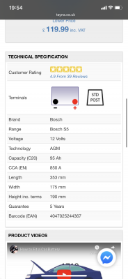

If the worst happens and its a new battery, I'd check the price from Tayna, then get a quote from MB Grangemouth with a mention of the forum for the best discount.
019 AGM Car Batteries
As another indication - how old is the battery? With todays heavily electronic dependent cars over 3 years -suspect--- over 5 -renew as a matter of course
I believe the Bosch S5 has a 5 year warranty. MB will only provide 2 years.
ECP may price match Tayna for easier returns.
If its stop/ start it will have an AGM battery.
Only a 3 yr guarantee with them usually:(
I thought that too but Bosch have started offering 5 years. (About time :))
Thats good then. Last I looked a few weeks back ECP had Bosch AGM batteries and the guarantee was only 3yrs. 5 yrs is far better.

Where was that Bosch battery at that price.....?
Tayna , according to the logo at the top of the screenshot in Post #10
it was on Tayna.
the Bosch battery price is £190 delivered.
That's where I looked......
Can't find it (in my size) at that price.
Ho him, will shop around
Cheers
Cheers
The price in the screenshot was for Enduroline, appeared in the screenshot when I was looking up the guarantee for the Bosch
