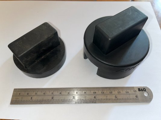

Best I can suggest is searching Amazon for 'Autoxbert jack pucks' they have all shapes and sizes. The one on the left is the 'stock' size for a C class 203 (and other MB's) , the bit that goes into the sill hole is 25mm high (total height is 40mm) x 23 x 55, base diameter is 70mm .
The one on the right is the same in regards to the part that fits into the sill hole but has an overall height of 65mm and is grooved with a 'bulge' within the groove to fit on to and axle stand like the yellow ones here. My car obviously has an AMG body kit (as do many non AMG's) and these pucks are very close to the 'plastic' part of the side skirt when in use, but they do the job.
