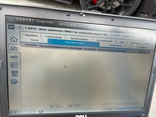

When I changed my exhaust to a Catback Titanium exhaust system on my E53 Coupe mine would also go into limp mode (no boost) if I floored it. Quick restart and the boost would come back again same as yours except the error code I got was a P029909
