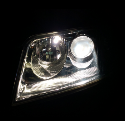

What's the road legal ones. It's a company car so has to be road legal
Stock
Ultra 5000K
In another car
