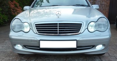

Just to let you know, I replaced my front fog lights with LEDs, it renders them useless as 'fog' lights, though they act for me a pseudo DRLs. The original bulbs you have in now are much better at cutting through fog rather than the white LED illumination. As long as you are aware of that, fill your boots...
i know they will be useless as lights but to be honest i can live with that, just dont like the yellow light against the xenon white.

Yes, but they were purchased as 'canbus error free' and came with a resistor which emulates the loading of a standard bulb, so fooling the car into thinking all is OK. You should be warned that the resistor gets quite hot (it's encased in a small metal box), so make sure it is mounted to something metal so the heat can dissipate safely away...
so you bought the kit with the separate resistors yes ?
