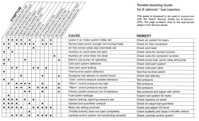

Dont spend on parts until you get an answer on the forum . First of all when did you have the HT section serviced like plugs distributor cap and rotor plus the ht leads ? do you have the M103 or M104 engine .

Ray what ever,, but still the ht system needs checking out before injection system is looked in to So now - 1)faulty ECT sensor(important for cold starts), 2) old/wrong spark plugs, 3) faulty under coil connectors, 4) fuel pump relay, or 5)major vacuum leak(s).
