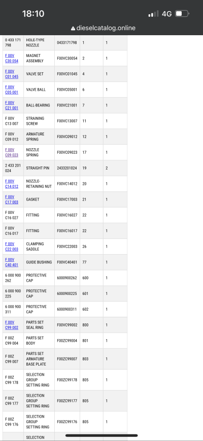

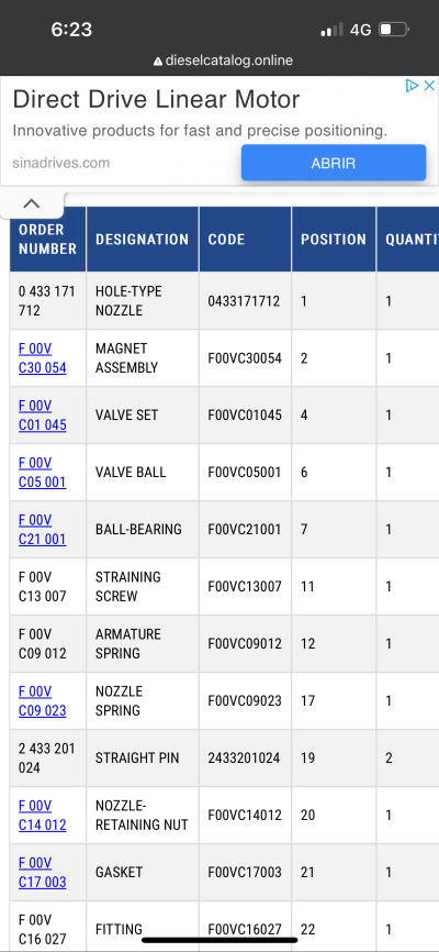

I intend to get AMG injectors, and map sensor, I would like an upgraded intercooler, but I don't think there is much room on a c class
well i have been doing a bit of research into the AMG injectors specs to my 270 cdi, as i was told it is not a straight swap for the AMG nozzles, the only other difference in part numbers are the copper sealing ring and the protective cap on top of the injector, so i will give it a go when i get the parts
602 is just a cap to stop dirt going in the top of the injector when new or reconditioned
750 is just the copper washer used to seal the injector on the head.
I thought that, but guys are telling me the AMG injectors are different apart from the nozzles, I can't see the difference
Number 4 valve
0 445 110 151, Injector CR, Common Rail system BOSCH, 0445110151
Amg injector number 602 and 750 are only differences
Ml270 injector vs c30 cdi amg
Number 4
320 cdi 197hp injector is the same just the nozzle
