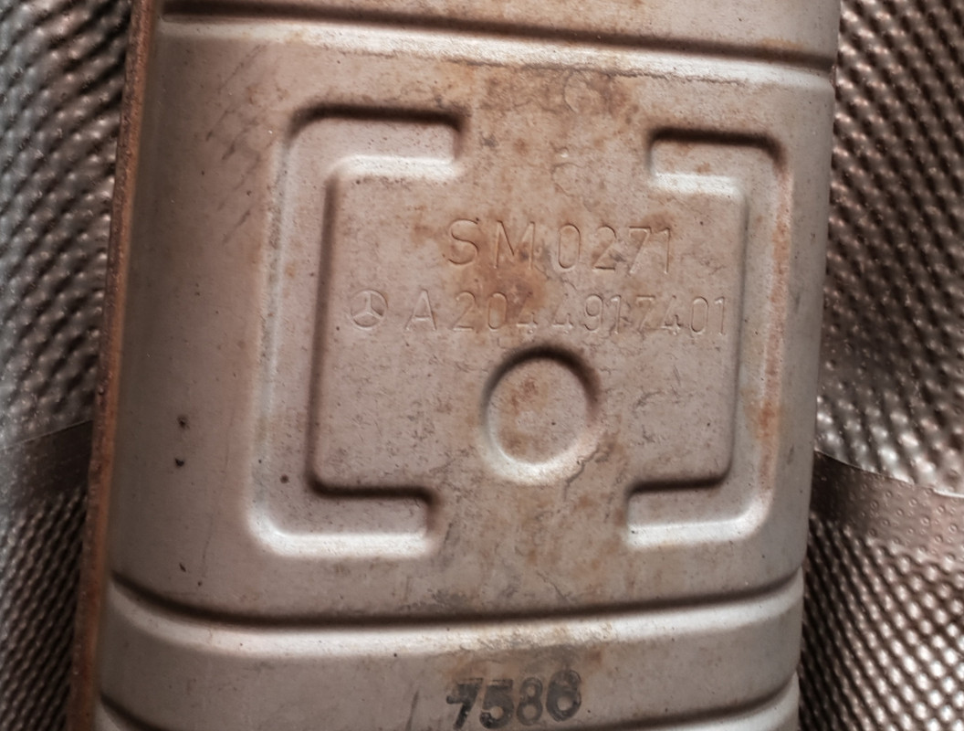

If you can get under the car, you will see a part number stamped on the underside of the cat.
This is what it looks like on a W204 for example:
If you can locate this part number, you'll be sure you got the right replacement part.

Thanks for that, I can’t really get under car right now but where will I find the cat, at the front?

And will there not be a casing under the car preventing me from seeing these parts?
