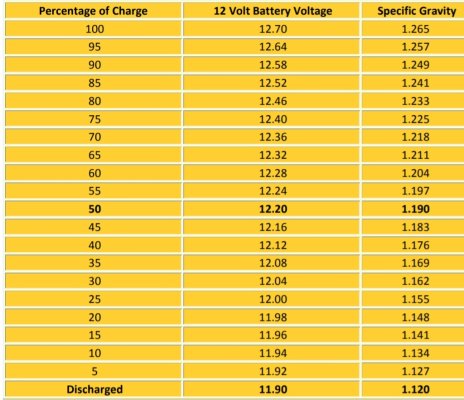

But as mentioned the battery should be way above 11.4V ... for a wet lead/acid battery 11.9V is fully discharged, and for an AGM one 11.5V is around 10% charge remaining.

I checked the battery again this morning and was 11.9v before starting.
With the engine running it went to 14.7v
I have tested the battery to make sure nothing is draining the battery when switched off & that is all fine.
Will keep an eye on it but seems like weak battery unless i am wrong.
Yup if the battery is getting 14.7V with the engine running it should charge. Maybe check the resting voltage 30 mins or so after a run to see what it shows then.
