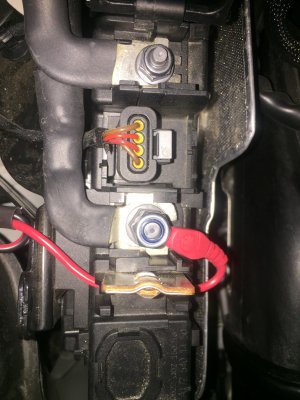

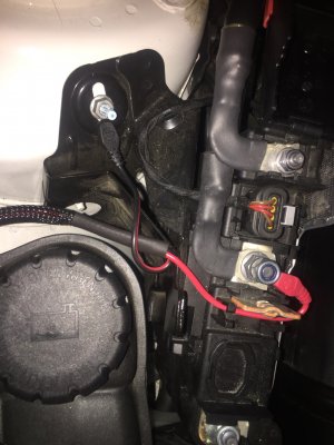

I modified the CTEK lead terminals to enable me to loosen the battery terminals just enough to push them between the washer and re tighten the nuts...ran the plug to near the washer fill up bottle...hey presto....I used a pair of wire cutters to open the wire connectors from a hole to a horse shoe shape...Mine's a 2016 model S205

This is a picture of the install I did on my SLK.

That's what I had in mind doing something similar using the terminal box.
Lots of people have done this with their SLKs , have a look on SLK World.com and do a search on Ctek chargers . You will find better pics and more details on their . Hope this helps
