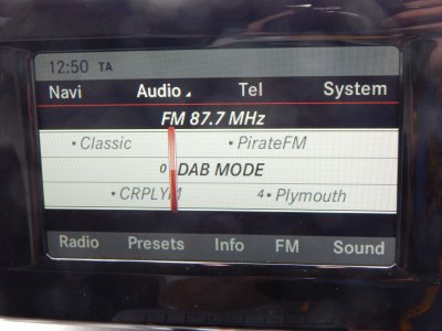

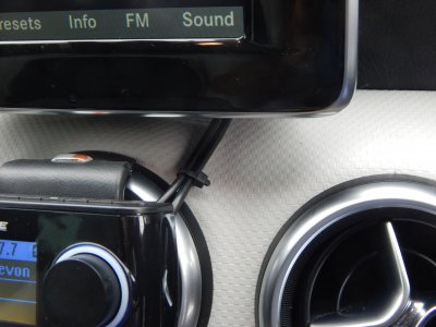

Only last week I bought a Nextbase DAB 250 & fitted it into my late 2013 A class.
I removed the display screen & glove box (look on youtube for instructions) & fed the supply cables through the hole in display screen bracket & out into the glove box area & connected the Nextbase hardwire kit to the cig lighter fuse. the antenna cable was fed up & behind the passenger A pillar as per Nextbase instructions. The unit worked as describe & tuned itself into a vacant fm slot & I was easily able to tune into DAB stations. cost was IRO £50. Photos to follow.

Sorry Guys thought I included the photos, must be those grey cells failing again
