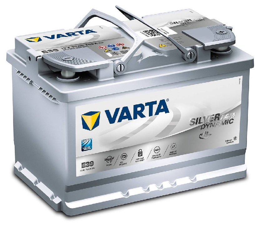

just an update the issue has been happening everyday now and the car was slow to start yesterday so I put on a new battery today I bought one from Halfords one of there own branded ones which I think are yuasa rebranded with 5 year guarantee.
And the problem has been cured ?
So has this fixed the issue?
I read a recent article that said the Halfords 5 year guarantee batteries are made by the same company that makes Varta batteries, but although the warranty is the same, I don't think they are just re-brands. There are differences.
What makes you think it is made for Halford by Yuasa? I am not suggesting it isn't, but I would be interested to know who Halfords order their batteries from.
Varta and Bosch batteries used to be made by Johnson Controls, not sure if that's still the case though.
EDIT: They have a new owner, it seems:
OK, it's actually on Halfords' website:
The visual comparison obviously helps, for those who can't read... :doh:
well so far it is ok its quite cold here this morning and its my first day back at work and started on the button and the ECO symbol stayed on and turned green after a couple of minutes then i turned it off, and i was only going by what i read about halfords batteries being made by yuasa but even so a 5 year guarantee is ok and the specs were the same as the one that came off .
