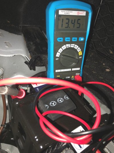

As others said, find your auxiliary battery first. The QR code inside the fuel flap will show you the location of the batteries in the car.
check the voltage with the engine off on both batteries., My main battery was between 11.8 and 12.1 and this was enough to stop the eco stop start working. My 8 year old battery wasn't holding anywhere near max capacity and that stopped the system.
I fitted a new main battery and voila its back working again. and its damn annoying!! LOL.... Also my brake hold had stopped but is working again now..
