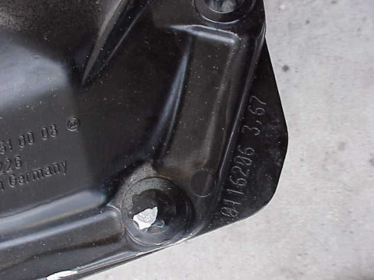

I can't find anything on those PN,s but the ratio is stamped on the flange at the rear:
Above example is 3.67:1
Thanks for reply Alexander, have checked the flanges but can't see the numbers you have identified. Removed the Ebay diff yesterday and compared ratios. The original is 3.25:1 and the Ebay one is 3.375:1. These are approximate measurements but there is a distinct difference of 45 to 40degrees on the input side. Unfortunately this means I am back to the same issue I had before the MOT as the original has a clunk . I intend to open it up and have a look. I am not sure if it is possible to buy the bearings and spacers seperately. Time for more research.
