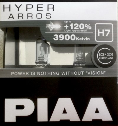

Everyone will have their own favourites but these are pretty amazing for only £21 from Powerbulbs.com
Highly recommended!
