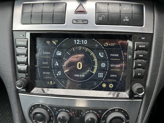

Not quite the same Mec, but I fitted a Hizpo Android to my W203 Sport Coupe. 8'' 7862 2din Android Car Multimedia Player for Mercedes Benz CLC W203 C-Class C180 C200 CLK200 CLK W209 GPS Carplay Auto 4G RDS - AliExpress 34
Prices seem to have gone up a lot, but I went for the S6 8-core with 8G ROM & 64G Ram. It was £140 at the time. Don't bother with less than 6-core device because they are too slow these days.
Hizpo do versions for most Merc centre console layouts, but do double check measurements.
As above getting all the wiring to the right places can be challengine, but once in place it works pretty much seamlessly with the car. It runs Google Maps, Waze, etc. I added DAB+ Radio & Agama custom UI (see pictures).
Main challenge was finding the correct CAN-Bus settings, but once this was done the steering wheel buttons, door open & reverse detection all worked with no extra wiring.
Both Android Auto & Apple CarPlay work well, although I don't use them mainly because call quality is better using the head unit as regular bluetooth hands-free.
Google voice search also works, but I cannot get it to link to Waze !!
Lastly, the unit is only 2.5CM deep, so plenty of room behind for all the wiring.

Yes I did specifically say it's for a W203, and not the same car. We had an Xtrons in my Wife's freelander for a while, but it was buggy & kept randomly rebooting. Swapped it for a buch more powerful Joying with more CPU & Memory.
Main thing is search carefully & check compatibility for things like bezel size & CAN adapter. Also delete most of the Chinese apps, and create a separate Google account for the HU. That way it will not delete your phone contacts !!
