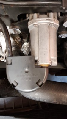

Also there's a slight buzzing noise coming from the part that's sits at the front off the engine (I've attached a picture) & it seems to lock the throttle linkage when trying to start the car. (I don't know if that's just the way it works)

Sorry I meant to ask if the 3 holes in the diaphragm should be clear as on mine only 2 of the holes are open. Don't know if that makes any difference to be honest.
Also is it normal when trying to start the car that the throttle linkage is locked as it seems to be controlled by the mechanism that I took the picture off.

this video may help? its part of the throttle actuator mechanism for the M119 and possibly part of the ASR system also. If I got this right it should move as you actuate the throttle?

Also wanted to ask if it's normal for the mechanism on at the front of the engine (not sure what it's called) that I took picture of to make a buzzing noise.

Sorry if this is a stupid question but is that the piece that's attached to the bottom half of the fuel distributor.
Thanks again & sorry if it's a silly question.
Glyn.
It appears to be a "drive by wire" system- the throttle pedal is attached by cable to the sender / potentiometer unit at the rear of the engine which signals to the actuator motor at the front only by wire [ this so the ASR system can intervene and modify the accelerator command] --From the actuator motor there appears to be a purely mechanical linkage travelling backwards [UPPER ROD] and then forwards[LOWER ROD] to open the throttle butterfly below the fuel distributor--- the potentiometer idle contacts are supposed to give trouble and cause the car to go into limp home mode
