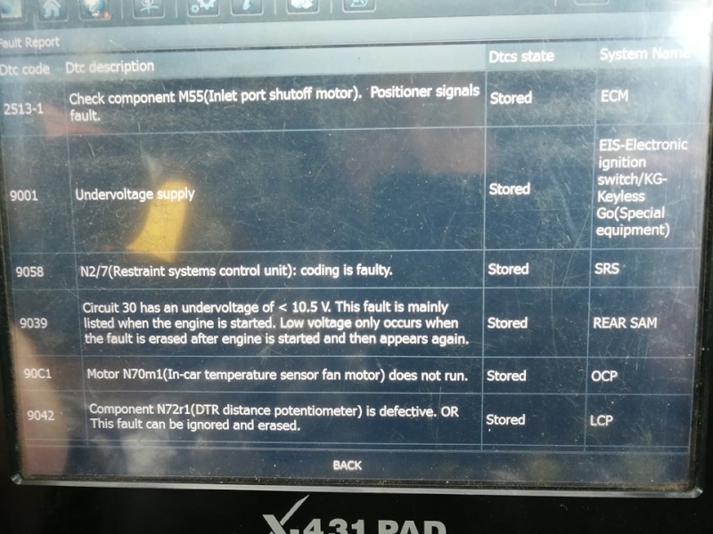

Yesterday i got controlled, car worked fine all day, but there was alot faults only few came back 9460 9470.
please help where to start, cleaning air flow meter ?
What is interesting is usually those faults all go to current because the inlet motor blows a fuse...

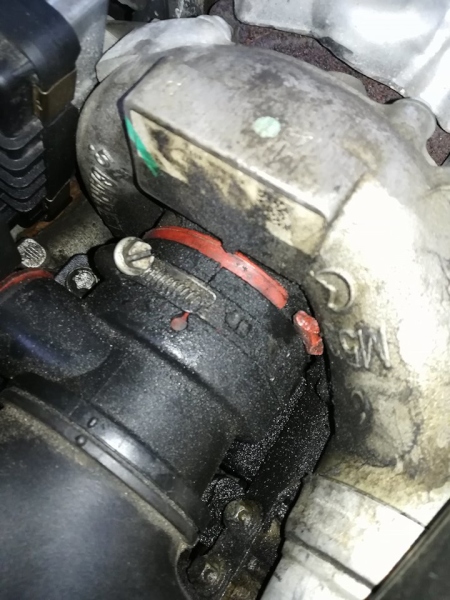

I just took some pics of my engine, can u tell me how bad it is, there is no engine light or something, care loses power, is there any easy fix like cleaning connectors ? plz some good adivce dont have a lot of money.
should i bybass this valve ?
