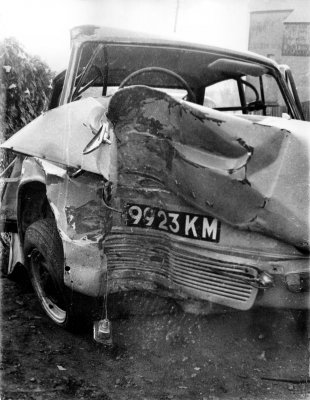

I came by a 998 engine so tuned it up and swopped it over for the std. 848cc engine when i had my own Imp... i was in the process of changing tyres from crossply to radial and had this terrible accident.
Hit a large lamp post at 70mph and was flung out the car on the road my right shoe being left under the throttle and my left shoe in the back parcel shelf.
The drivers door split it two and left the inner sheet complete with handle still hanging on the hinges, my right knee pushed up the steering wheel through the screen while the left knee went into the heater flap.
The floor to the back seat ended up being in 3" high ripples....the floor had opened up under the throttle but luckily my foot left the shoe behind in the hole.
All in all not a very good experience seeing also i had just filled up with fuel which was leaking on the road next to me!!........tank in the front boot.
You can see in the pictures how well the Imp took the bang you could stand in the large dent the lamp post made and still be flush with the front of the car.
I hit the lamp post off centre as it just understeered dramatically .....so the car spun around the post.
The rules then were mixed tyres were allowed so long as the radials were on the rear so my front crossply`s which were due for renewal the following week never got changed.
The extra grip on the rear just simply shoved the front away into the post with NO warning and on a dry road.
