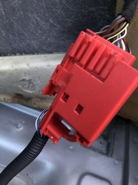

Hi,
I'm taking the seats out of an W169 A180, and I cannot get this plug undone. It's under the seat. I have managed to remove part of the outer casing but the male part will not come loose. It's taken three hours to get this far... I'm tackling the A-class flooded interior problem which has messed up the COMAND system and possibly the ESP, so it would be good to remove the carpets and get it all dried out first.
Does anyone know how to release it?
Cheers
If it's SRS related there will be some sort of locking tabs that need to be released. Reason being that you will have pyro/explosive seat belt anti submarine devices. They are designed to be hard to disconnect to prevent air bags Etc deploying, the fact that it is red may be a clue. Battery disconnect for an hour before you do anything.
