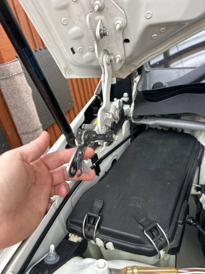

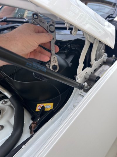

Ok I’ve had a quick online look and search here but it’s usually quicker to ask you guys so here goes…. How to fully open the bonnet on this 2012 E250 coupe?
I’ve found these two silver brackets which can be removed but the bonnet doesn’t want to open any higher, it feels like I’m going to break something if I keep pushing it.

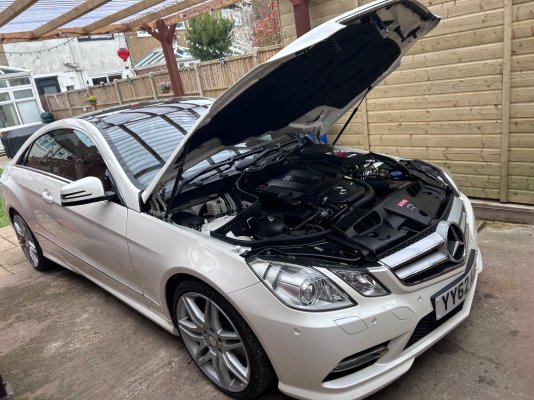

YouTube showed a guy disconnecting those two silver brackets in my photo and then simply and very easily pushing the bonnet up to the service position at 90 degrees…. Pffft I’m scared to try as it’s so tough!
Yay… did it, sorry all 🤣
Just disconnect the top of each silver bracket and then PUSH UP!
It now hits my car port roof 😇
