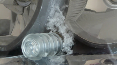

I've been slow to remove the condensation in my headlight housing. Now I have several breeds of fungi growing inside.
The housing looks to be a sealed unit, other than the small service hole in the rear. With all the electronic connections inside I'm reluctant to slosh water inside.
Any suggestions for how to remove the mould?
Thanks.
Well I tried various things and eventually gave up and went for warm soapy water sloshing around inside. All the mould has gone and it's now drying over a radiator. Well see tomorrow whether the lights work any more!

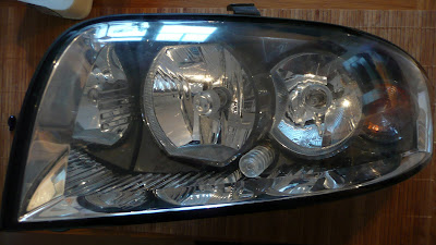

The cleaned lens :)

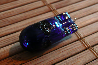

But I did find that the side-light bulb was melting on the bulb lens rather than the electrical connections. These bulbs were free with my Philips X-treme bulbs I bought the other month. I've learnt again that there is no such thing as a free lunch.
