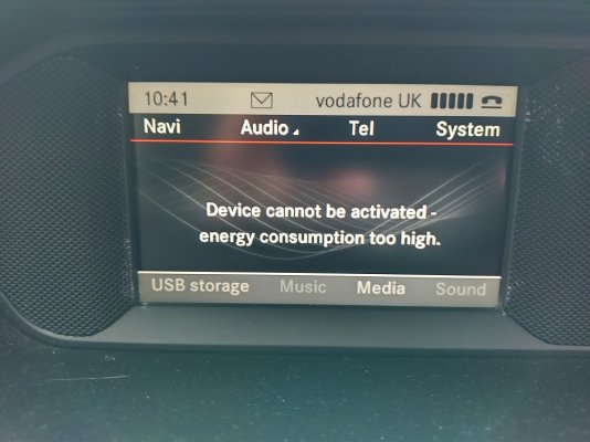

I have a 2013 W204 C220 and am having a problem when I turn on the radio or cd player. I'll attach a picture but basically the problem is sometimes I get a message saying
"Device cannot be activated. Energy consumption too high"
If I keep trying to turn on the radio eventually it will stay on but it is annoying. I don't know if this is connected but the stop/start function doesn't seem to work either and has not done so since I bought the car 18 months ago. I'm not bothered by that as I don't like that function and would turn it off every time I drive anyway.
I hope someone can help or give advice. Thanks in advance.

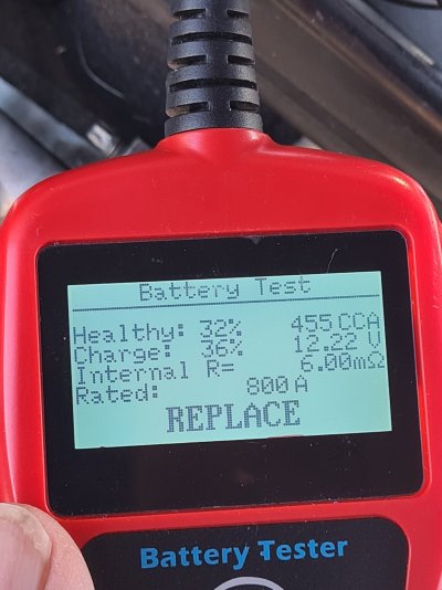

I have a battery tester, but it only works with the main battery in the engine bay, I get funny readings when testing the auxiliary battery in the boot.
That's the unit I have:
So it seems that for some reason testing the auxiliary battery isn't straightforward. Have you trued measuring the battery voltage?
