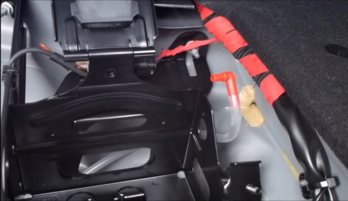

Ok, so a final (I hope) update on this problem.
I had the main battery changed at Halfords, £185 fitted. I drove the car for a few days and couldn't see any difference, the problem still persisted. The guy who fitted the battery said that they came 80% charged so it could take a few miles.
80 miles later no change so I ordered a new aux battery from eBay, link below. A cheaper alternative to the oem battery. £43.50 inc delivery.
It arrived the next day and was easy to fit. Happily after driving about a further 30 miles The Radio/usb player are now working and for the first time in about 2 years the stop/start dash light turned green and started working. So, hopefully that problem is behind me.
Many thanks to all who offered help. Much appreciated.

I've a facelift C Class too , I've removed the auxiliary paperweight
and my main battery is not healthy yet no such HU message or any other issues .
I did ask the guy at Halfords about removing the aux battery and he said not to as it could do a lot of damage to the cars electrics.
Seems to work for you though.
I always switch off the stop start but I think the fact that it now works shows that the electrical system is now healthy, I hope so anyway.
