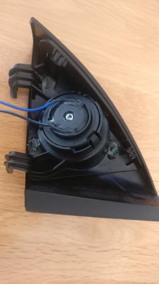

My first step is to address the top end. I have done that by mounting some Alpine tweeters in the empty tweeter apertures in the front doors.
These are the tweeters I fitted:
They are only 30mm in diameter and the recess for them is 40mm so I 3d printed some adapters (a hobby of mine):
...which then fitted into the door tweeter panel:

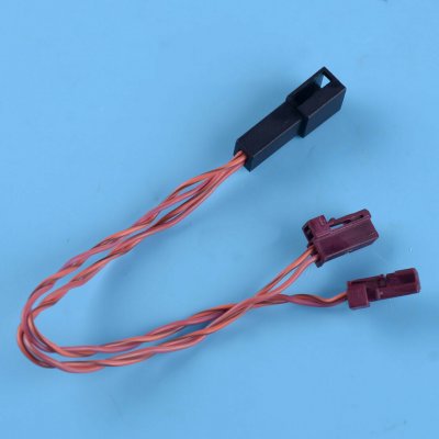

... and I used one of these speaker adapter 'Y' slitter cables so that I didn't have to cut any wires.
I have to say the results seem to be great. The high end is brighter but not shrill and I have to say I am pleased with the results so far. The problem now is that the rear doors don't have any facility for fitting tweeters so I may look at replacing the 4" single cone speakers in the rear doors with 4" two way coaxial speakers.

Do you have any pictures of where you connected the wires by any chance?
No, not a useful picture I'm afraid. However it's not difficult if you use one of these adapters that I linked to in my original post.
Just unplug the plug on the existing door speaker (yellow plug) and plug it into the black connector on the adapter. Then plug one of the brown connectors on the adapter back into the speaker and the remaining adapter wire you need to connect to the new tweeters. You could either connect directly onto the plug or cut the plug off and just connect the wires directly to the tweeter wires.
