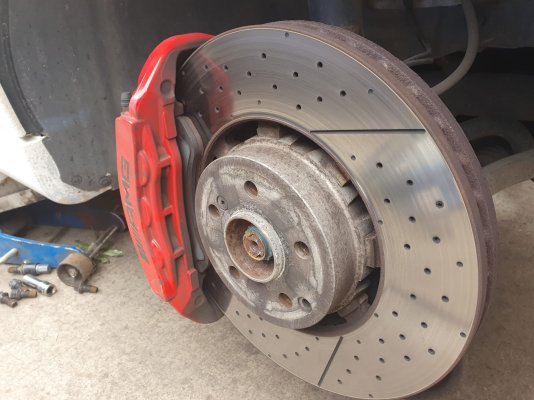

Apart from the Black Series they all have the same caliper, just different colours. All the discs are 360mm front and 330mm rear.
The discs on that car should look like this.
Facelift cars use ones like this, which arguably aren't as good. Same sort of weight but not floating.
Thanks Steve. It always baffled me about the discs on the car because I would be looking out for the colour just. With the floating disc it is quite easy to spot then.

These are genuine ppp discs to give you an idea
