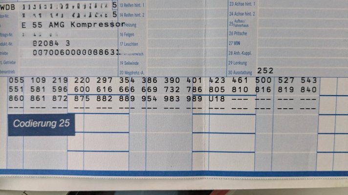

Is keyless entry listed on the data card ?

Not an S211 but I have a similar age Mercedes with keyless entry and touching the rear handle unlocks the car.
This is the datacard but not sure if there is a list somewhere that shows all the codes with descriptions.
