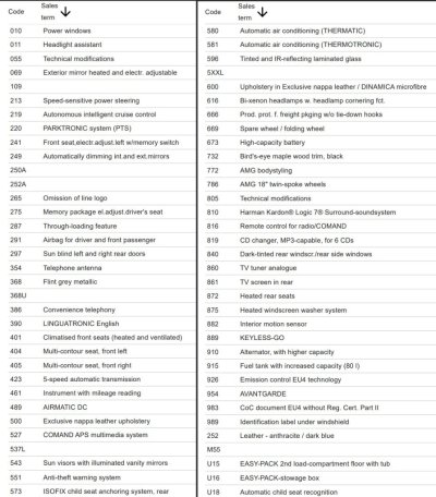

That VIN decoder seems to redirect to Car Vertical currently. Found another one here that worked a treat:
Shows Keyless Go Option 889 on there. Seems quite a high spec car and not too much missing.

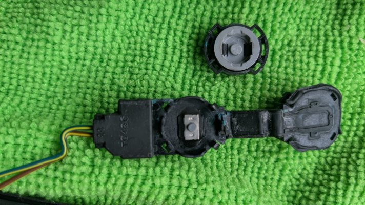

Dry fitted the replacement passenger keyless go part and all works a treat.
Before I permanently fit I thought it would be interesting to break the original one apart. You can see why it breaks down with clear evidences of water ingress.
Just seems a known weak link on these cars mainly due to poor design and longevity of the OEM part IMHO.
I prefer to try to find a better replacement option that will last longer due to an improved design. I don't mind a bit of my time to create a better solution also with the bonus of being at a lower cost than the OEM part.
I suspect the passenger handle has already been replaced at least once before so hopefully this might be the last time it will need to be replaced.
