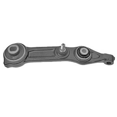

Looking for some Track control arms, Lemforder are coming up at £180 for a pair at ECP, TRW £130 at GSF.
I have always gone with lemforder, but GSF don't have it for this item? Is Lemforder worth the £50 premium?
I have heard TRW is an equivalent premium brand anyway...
both owned by zf so parts will be equivalent in quality . i just fitted trw to the cls yesterday , cant fault them ....
I am having a think, the middle ball joints on the arm are shot. So rather than just replacing the ball joints separately (£40 for the pair) I think maybe its more viable to replace both entire arms (£135 for the pair) as then the 2 bushes on the arms will also be renewed? They look quite old.
What do you think?
What do you think?
i replace the lot whilst its in bits. if its knocking chances are its the lower hub ball joint , best change them whilst its in bits also .

Lower ball joints changed last week already bud ;)
Yeh I also think just change the whole arm. Will update in due course.

TRW are OEM. I replaced all of my CLK's front suspension with a mix of trw & lemforder - my guess is it's the same but in different packaging. Would just get whichever is cheaper.

Yes, this is what I would do, get the whole arm complete with bush and ball joint.
