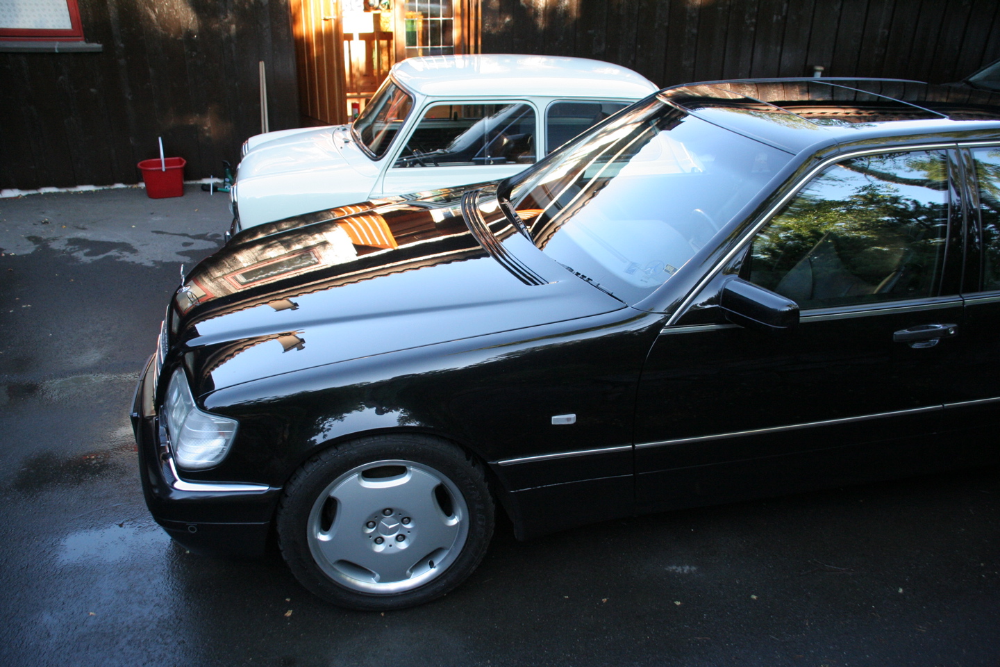

has anyone seen these rims fitted to a W203 before?
Not dissimilar to AMG Style II
i had AMG style 2 fitted on my passat, it looked awesome.
i think the coupe wheels somehow look bigger
