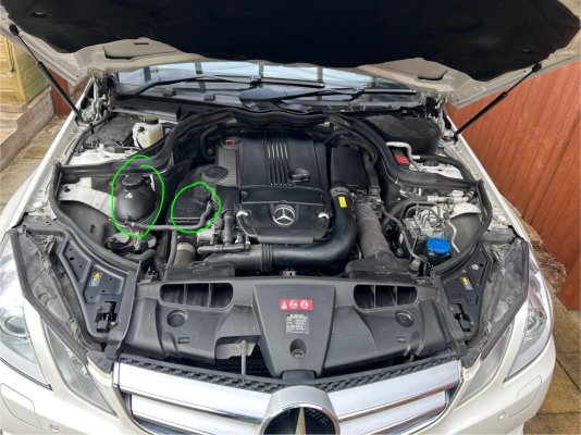

Hi all just got this new to me 2012 Petrol E250 and would like your quick help identifying these two tanks… is the left one for coolant the right side for brake fluid or power steering fluid?

I'm not familiar with that engine, however, the left one should be the coolant header tank. The right hand one looks like the power steering reservoir and a check of the part number appears to confirm that, see link:
A couple of points if you're not aware:
A. A 2012 car will probably be running on the older blue/green Mercedes coolant (can't recall the spec. number), with a 15-year change period. Later cars use the red coolant, with a 10-year change schedule. The two types are NOT interchangeable / mixable.
B. Power steering fluid; most (maybe all recent, so including yours) use a specific fluid, not the normal older type of atf-type fluid, again with a Mercedes spec number. It will be in your handbook, or somebody on here will update it. I think Fuchs supply the correct spec fluid, green from memory.
The above are my thoughts, not definitive answers as I don't know that model/engine - I say that after advising somebody who then proceeded to fill their coolant header tank with windscreen washer fluid after mixing the two up, which, fortunately, I spotted ;)
And remember , if you are thinking about replacing the power steering fluid (which you should be contemplating after more than a decade) the expansion tank in your photo is a throw away service item.
The one and only filter in the system is moulded inside it , cost about £35. There are two types of fluid one for older cars , one for newer models. Make sure you get the correct one .
The colour of the stuff that is in your car if original (old) is no indication on the one you need .
Total volume is around 1 litre.
The brake fluid reservoir is further back, directly behind the coolant reservoir. It has the white tank.
The blue and red coolants from Merc are apparently able to be mixed, but good practice would be to do a complete replacement.
Red and blue from other general brands are probably not mixable.
The 15 years/10 years only applies from new, due to the packet of whatever it is trapped within a new coolant tank to preserve coolant properties. I bet if you start swapping fluids around, or doing drain downs and refills, the people in the lab who developed this say the 15/10 years no longer applies unless you do a complete new fill with new coolant tank.
Do MB put Silica "T Bags" in expansion tanks? I only ask as it's a known issue with VW group cars that they can split and the contents block the heater matrix. I've not heard of that being an issue on Mercs. Maybe they use a better quality T-Bag :dk:
BTW, it's the M271 engine. Turbo, not Kompressor.
Yes in VW. Yes also heard of splitting in VW.
Yes, bags put in Merc expansion tanks (I shook mine when I fitted a new tank in December and it was very apparent.
No answer regarding splitting in Merc tanks, but haven't seen any reports, unlike the more publicised issues with this on VWs.
